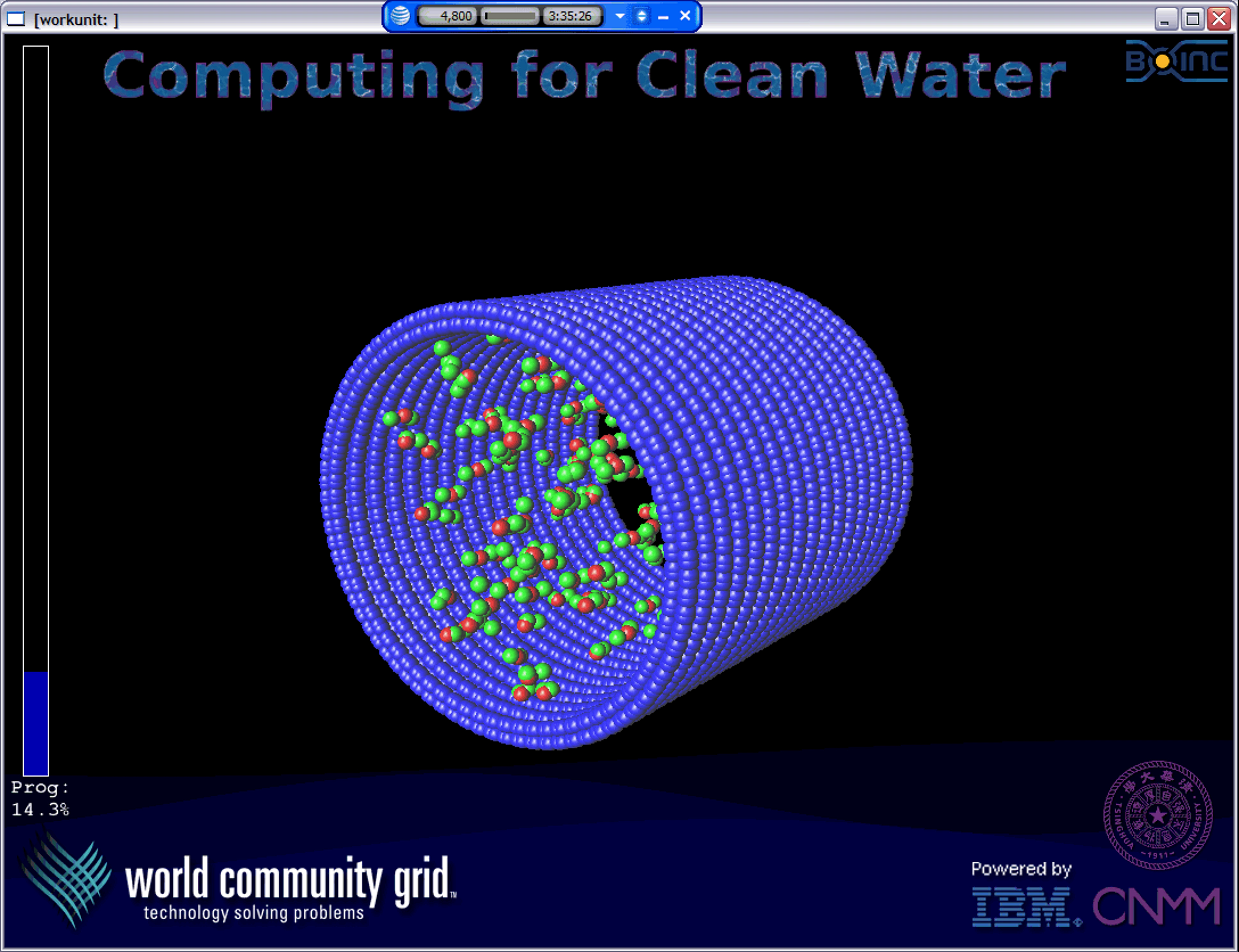

    Screen saver/Graphics: What does the screen saver look like for Computing for Clean Water?
    Here is a video capture of the computing for clean water graphics:

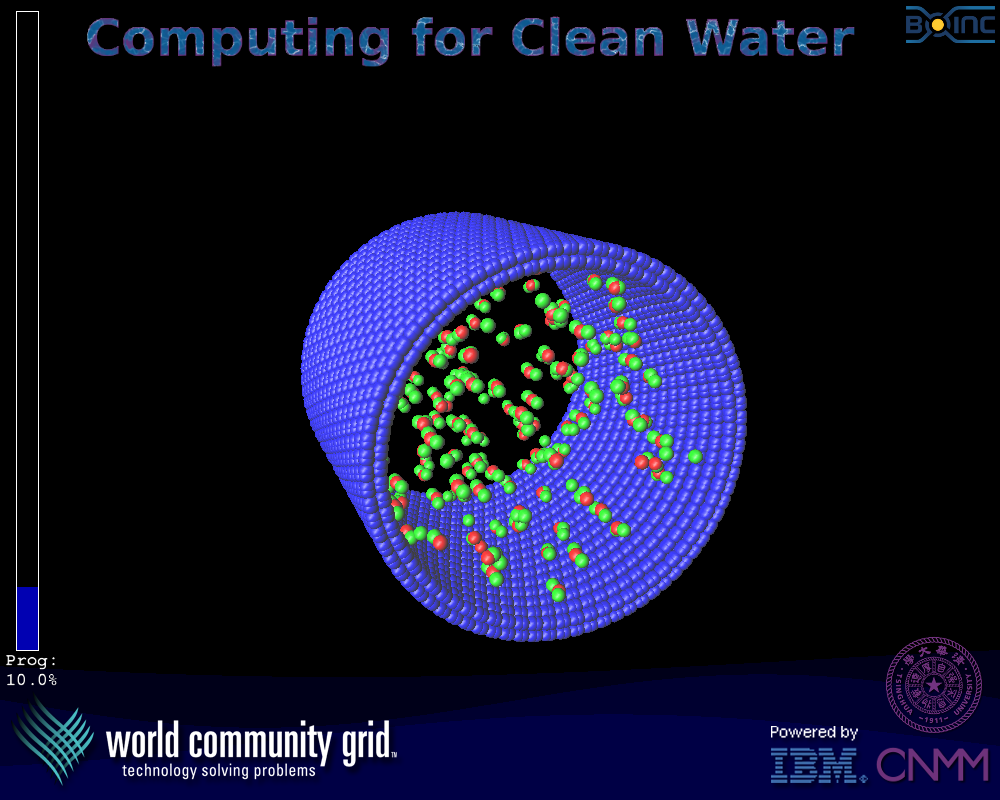

    Screen saver/Graphics: What does the screen saver show?
    The main center of the screen saver shows the atoms of a carbon nanotube surrounding a sampling of water molecules inside. The positions of the atoms match the computation your computer is performing at that time. The carbon atoms are shown in blue. The water molecules consist of oxygen and hydrogen atoms shown in red and green. About every five minutes, the nanotube is shown alternately in full size or as a close-up near the wall of the nanotube. More of the water molecules are shown in the close-up view. At the left, the "Prog: nn.n%" shows the progress computing the current work unit in percentage complete. The dark blue background shows waves of water which move slowly and climb in level along with the progress of the work unit.

    Screen saver/Graphics: What does the blue tube-like object represent?
    The blue tube-like object represents the carbon nanotube through which the water is passing in the computer simulation. The blue spheres are carbon atoms. In some of the work units, the carbon nanotubes may have two layers of carbon atoms and in some there may be just one layer. The size of the carbon nanotube may also vary with work unit. Every 5 minutes the screen saver switches between a large view and a close-up view near the wall. The close-up view shows more of the water molecules present there in the simulation. In the larger version, only a sampling of the water molecules are drawn. This is done to limit the computer time required to show the picture.
    Screen saver/Graphics: What do the green and red bubble-like objects inside the blue tube represent?
    The red and green spheres represent the atoms forming water molecules. Each water molecule has two hydrogen atoms (green) and one oxygen atom (red). Not all of the water molecules are drawn to limit the use of computer time spent on creating the graphics images.
    Screen saver/Graphics: What do the waves in the background represent?
    The dark blue waves in the background are a background decoration. They move slowly and their level rises with the percentage completion of the particular work that your machine is working on.
