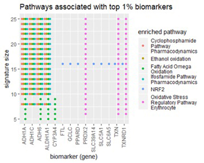

Pathway enrichment among the top biomarkers
To get a higher-level view of the biomarkers discovered in the lung dataset, we examined them from the pathway perspective. A pathway is a group of genes that cooperate to perform the same biological function. We fed lists of top-1% biomarkers into our lab’s pathDIP database [1], [2]. pathDIP is a comprehensive, integrated database of known pathways (signaling cascades), and given a list of genes, it will find all pathways associated with any gene in the list. Most usefully, it will measure the enrichment of each pathway in your gene list – the degree to which pathway has an above-average connection to your list. Using such analysis, we aim to find biologically meaningful interpretation of our identified biomarkers.
The figure below shows the results from pathDIP.
Figure 4
Across a large number of signature sizes, pathDIP consistently found five pathways enriched in our gene lists:
- Cyclophosphamide Pathway, Pharmacodynamics
- Ifosfamide Pathway, Pharmacodynamics
- Ethanol oxidation
- Fatty Acid Omega oxidation
- Oxidative Stress Regulatory Pathway (Erythrocyte)
All five enriched pathways relate to metabolism, meaning the breakdown of chemicals in the body. Curiously, the first two pathways relate specifically to metabolism of chemotherapy drugs, Cyclophosphamide and Ifosfamide. The last three relate to either oxidation or the prevention of oxidative stress (free radicals) in red blood cells.

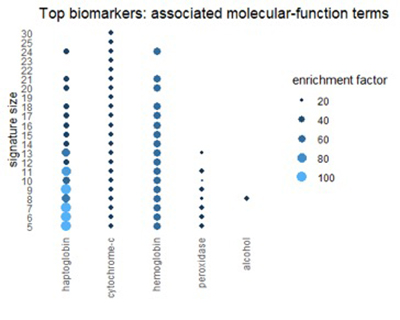

Using the Gene Ontology Resource to describe top biomarkers
We can get a related view from the Gene Ontology Resource (GO). GO categorizes each gene from three different perspectives: biological process, molecular function, and cellular component. The figures below show terms in GO categories that appear frequently in top 1% biomarkers.
Figure 5
Figure 6
Figure 7
Many of the terms reflect the themes found in pathways: oxidation, alcohol, and red-blood-cell chemistry.
