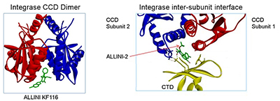

New Study on Computational Modeling of HIV
(Click image to see an enlarged version)
Figure: (Left) ALLINI KF116 (green) bound at the interface of two Catalytic Core Domain (CCD) subunits of HIV-integrase. (Right) ALLINI-2 (green) facilitating interactions between the CCD dimer and the C-Terminal Domain (CTD) of another HIV integrase molecule. Due to the presence of the ALLINI, the interaction between the CTD of one Integrase dimer and the CCD-CCD interface of another Integrase dimer is stabilized; chains of these inter-subunit interactions lead to aggregates.
An exciting study regarding computational modeling of HIV has come out of a collaboration with our lab and experimentalists at the HIVE Center.
HIV Integrase is a viral protein which plays a critical role in the replication of the HIV virus. A class of compounds, called allosteric Integrase inhibitors, or ALLINIs, has a unique inhibition mechanism targeting HIV Integrase. ALLINIs act like a glue that causes many Integrase molecules to become tangled together and make it difficult for them to complete their normal job, which is to incorporate HIV viral DNA into the cell’s own DNA.
Research scientist Nanjie Deng, an associate research professor with the Ron Levy Group at Temple University, has demonstrated with molecular dynamics simulations of HIV Integrase dimers how this process, which is called multimerization, is promoted by the ALLINIs. Deng’s predictions appear to be confirmed by a high resolution crystal structure which will be available later this year. An accelerated publication of his work can be found here.
